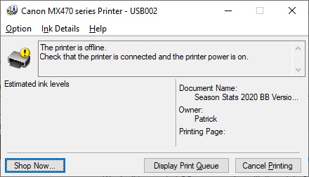

OS is Windows 10
Router/Modem is Netgear AC1900, connected to 2.4 Ghz, no smart connect that I know of
