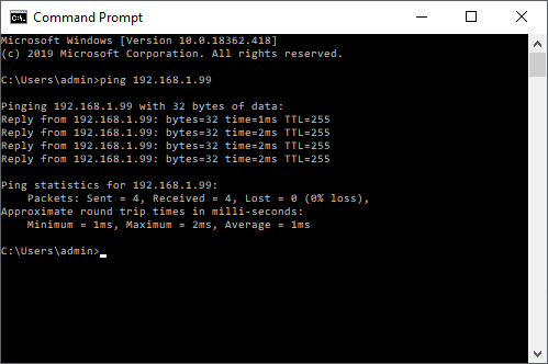

Are you using wireless direct or do you have the printer connected to a wireless router?
The last 12 digits of the "port' which is actually part of the printers host name is the printer's MAC address. You can reserve an IP using it on the router and give the printer a static IP.
Once this is done, you can confirm the printer is reachable using the PING command. Use this as the destination and any device on your network will always be able to find the printer at the IP you have set for it.
The IJ Networking Utility can be used to set the printer's destination IP in the driver, this way the driver knows where to sent print jobs.
Router (Reserved IP), Printer (mine 192.168.1.99), PING (reachable from command prompt) > same for all network devices.
