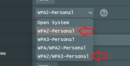

As I alluded to previously, the printer cannot connect to a 2.4Ghz wireless broadcast that uses WPA3 encryption. The 2.4 GHz broadcast must be set for WPA3/WPA2 combo or WPA2 only. If you're not able to find a way to do this yourself, please contact the ISP or manufacturer. I've not come across a newer device that doesn't provide this capability for backwards compatibility.
I'll post an image of mine so you can see what I'm referring to.

Update: Used a workaround since direct router settings would not allow me to change WPA type.
I setup Guest Access on router, which automatically assigned WPA2.
