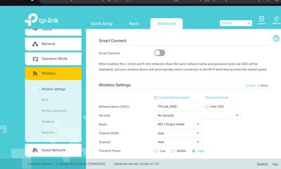

I have no idea how to tell if my router is on a 2.4 or 5G band. I have a TPLink Archer A7
12-26-2025 11:46 AM - edited 12-26-2025 11:47 AM
Greetings,
The archer A7 is a dual band 2.4/5G AC standard router. It only supports WPA2 encryption.
I always appreciate a manufacturer that supports emulators. Although TP-link being a foreign manufacturer has been under scrutiny for privacy concerns.
You'll need to log into your router and take a look at its configuration. The emulator is a great way to explore before you do it. Click on the advanced tab at the top, then the wireless icon in the navigation pane. Now click wireless settings. When the page refreshes look at the top in the center and see if the Smart Connect toggle is turned on? If it is then the router is configured to use the same SSID name for both bands. It might be helpful to temporarily disable this feature, then re-enable after a successful connection is made. Optionally you can turn the feature off and toggle between the two broadcasts 2.4 / 5G and give each broadcast unique names that will allow you to easily distinguish between the two.
Don't forget to press the save button in the bottom right after you make a settings change.
If you want to see which wireless devices are connected to your router click on the statistics menu option under wireless in the navigation pane and it will show you the clients connected to the router.
