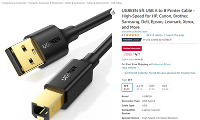

I've decided I'm going to just connect my computer via USB. If you're able to do the same, and want to, I found this one on Amazon.
[Swapped 3rd party link for image to facilitate discussion]
