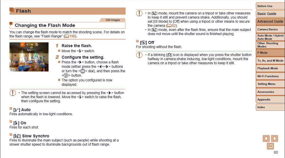

I am assuming you have the flash raised when you are experiencing the problem. One thing you could check is to see if the flash exposure compensation is set very low. If it is, try setting it higher. See below for instructions:
When the flash compensation is set to lessen the amount of flash, it may not fire if the camera senses there to be enough light for the photo. Also check that the flash is not turned off in the menu.
