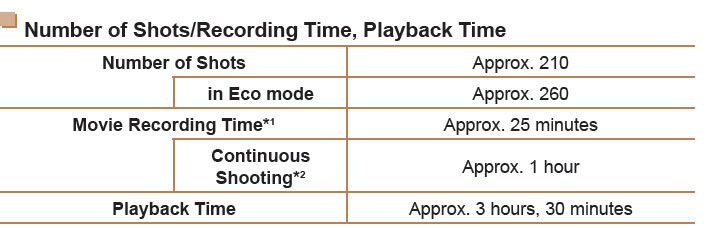

Pawl, these are screen shots from the manuals/user guides. Please note when comparing movie times that you are comparing 24 fps to 30/60 fps. That makes a big difference.
SX260:
SX280:
