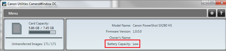

If you use Camera Window (Canon software) to download images, the opening window gives battery capacity. I had the camera in M mode when I connected the camera via USB, I turned it on and opened Camera Window. This was the display:
I then turned the camera off, changed to movie mode, and turned the camera on with USB still connected. I opened Camera Window and this was displayed:
I guess all this indicates is that Camera Window displays battery capacity as reported by the battery level indicator but clearly the battery cannot have two widely disparate levels at the same time. Incidentally, I turned the camera off a third time, changed mode to auto and turned it back on. This time Camera Window again reported the battery capacity as full.
