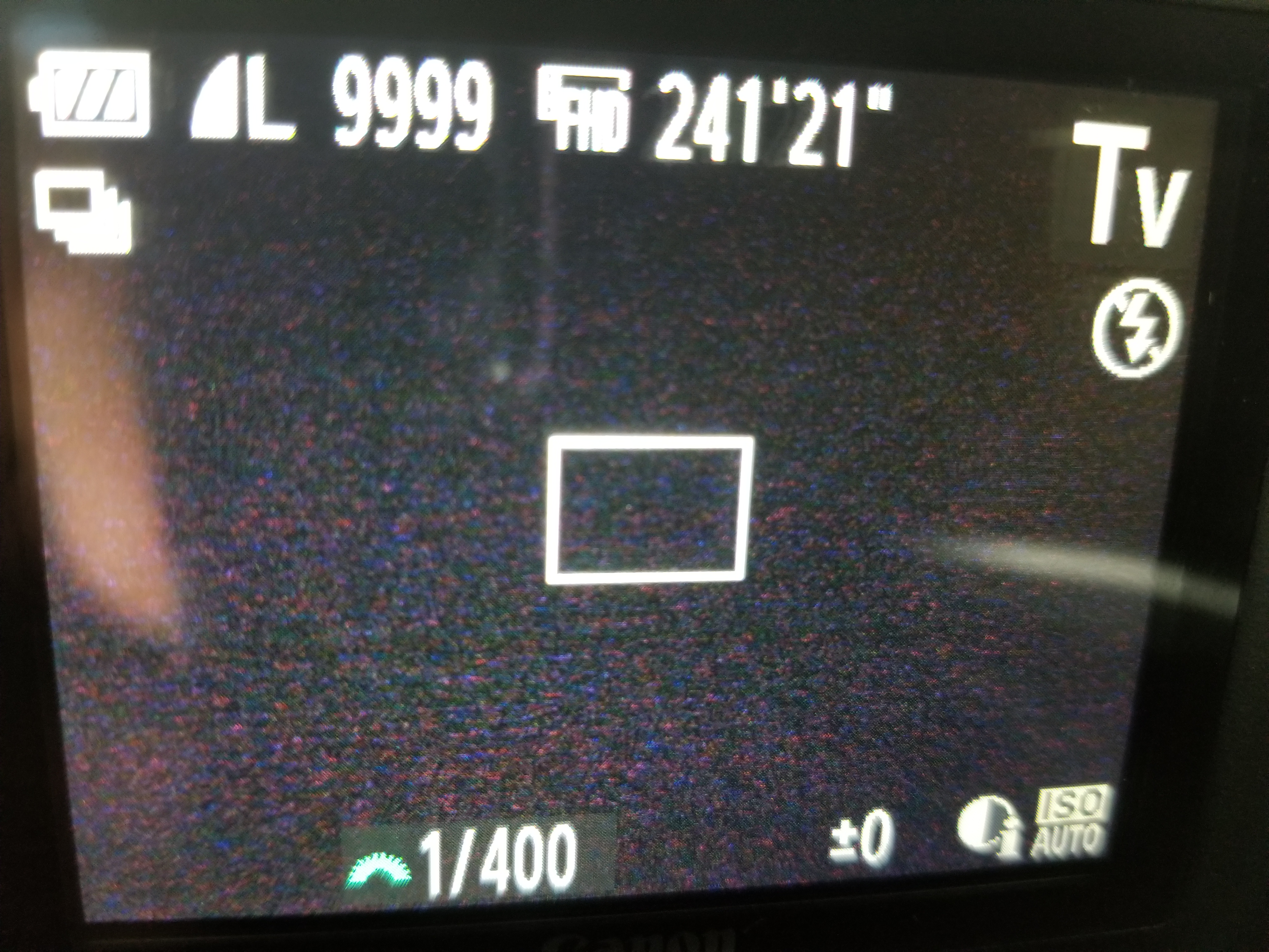

Hi, the ISO is on auto, not sure I can set the aperture in Tv mode as I see the message "set shutter speed, camera will select aperture." Hopefully, you can help me figure this one out.

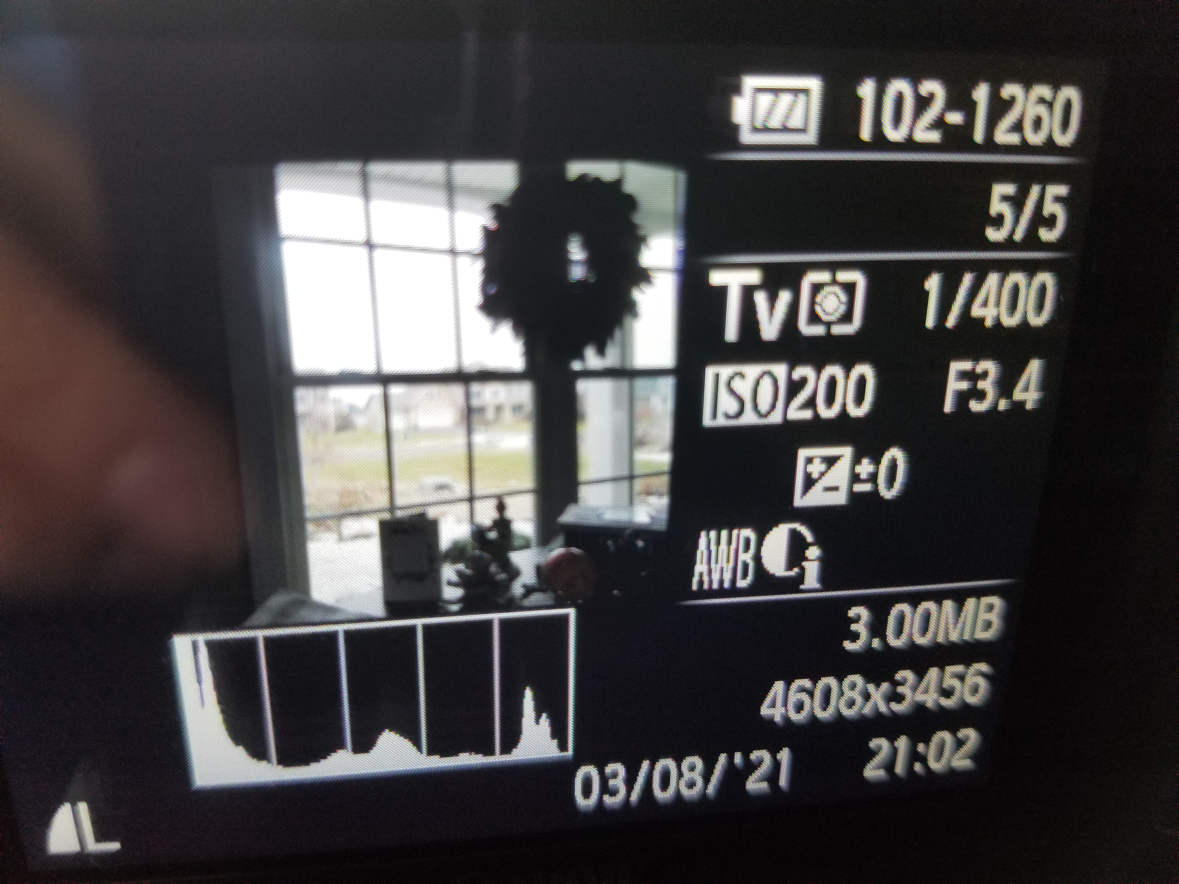

The metadata for your images should indicate what the aperture and ISO values are. That would be helpful to understand.
Your camera's lens' widest aperture is f/3.4. But at the telephoto end, it's f/6.5. Were you zoomed completely in? If so, unless the ISO can go high, I could see f/6.5 and 1/400s not allowing for a good exposure; hence the dark images.

Nope does not help, but if you go into playback and press disp or info, there might be an overlay of the shooting data.
If you change the ss to 1/60 do you get an image?
03-09-2021 09:07 AM
Is this metadata?
