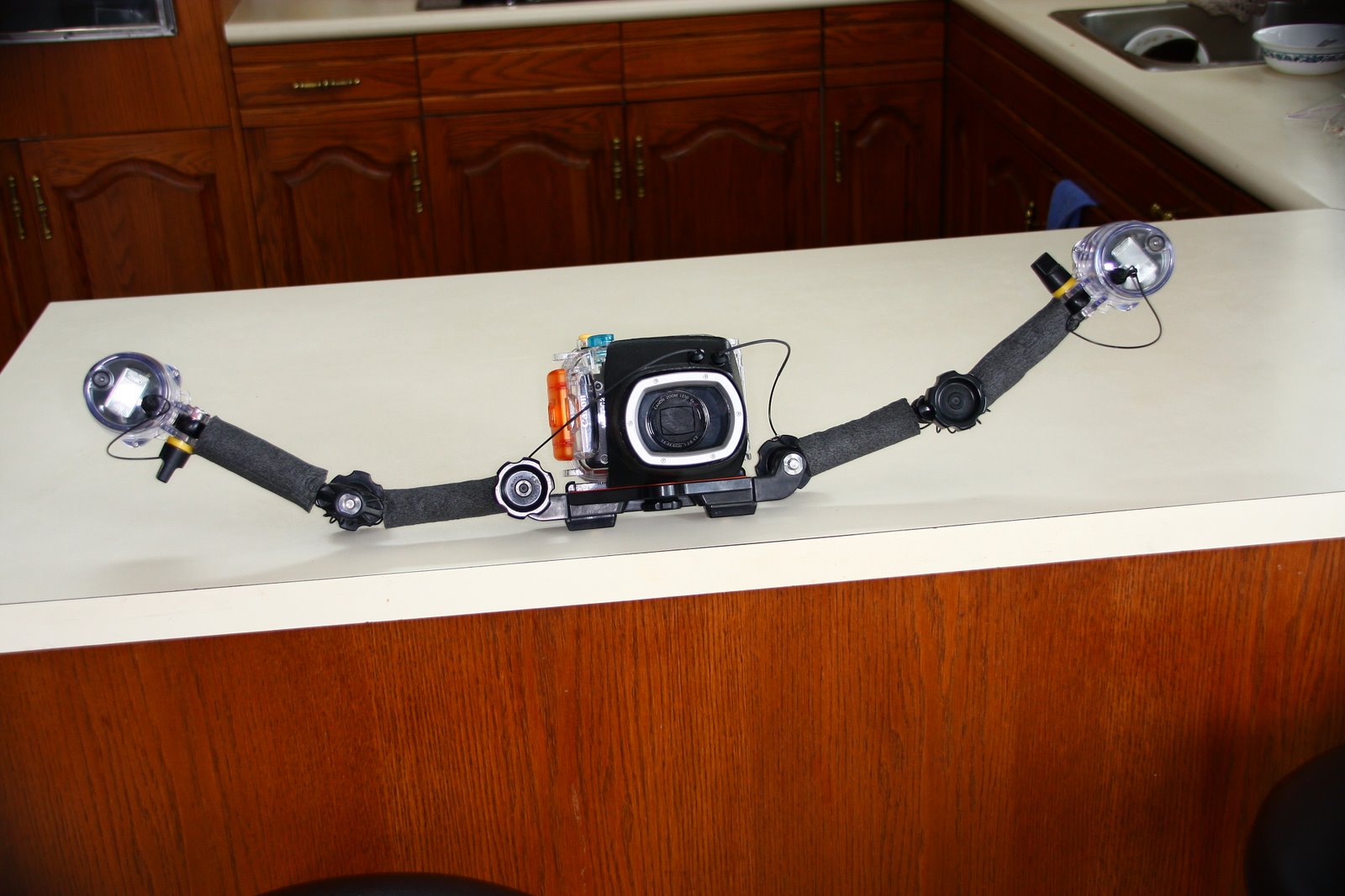

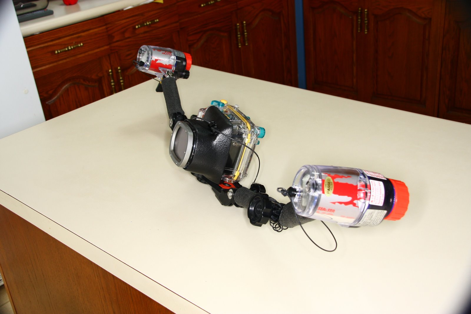

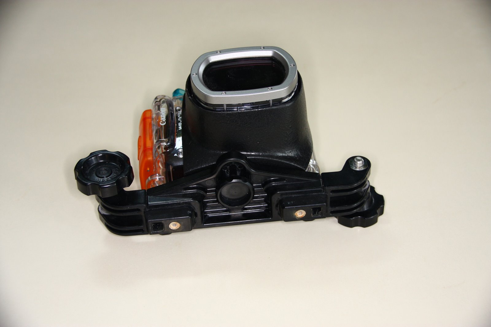

I don't have that housing but have the one for my G 9 & before that the S1 IS. I fire dual Sea & Sea stobes using fiber optic cables. What don't you like about the Ikelite & do you know if you can fire the Inon strobe via a fiber optic cable? You will not have an option to hard connect to the camera in the Canon housing. As for mounting strobes it's done by screwing a base plate (type of thing) to the tripod socket on the bottom of the housing. This is what my rig looks like but I made the black adapter you see covering the front half of the housing. It allows me a better way to attach the fiber optic cables right in front of the camera's flash. Note that the arms have a ball & socket arrangement half way out allowing just about any angle you want to place the strobe at. The inner & outer end are just a hinge.
