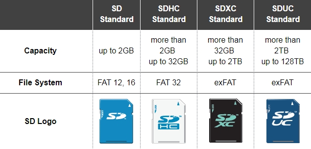

The Canon S2 IS can only accept standard SD cards and only up to a max size of 2GB. When I tried a 16GB SDHC card, I get the message " Memory Card Error"
SDHC cards are not supported by the S2 IS, regardless of the card size. The A2000IS can accept SDHC cards.
I was thinking that maybe the card you are having the problem with might be a 2GB SDHC card but SDHC cards usually start at 4GB. Plus the message you get is different from what I get with a SDHC so it must be some other type of problem.
