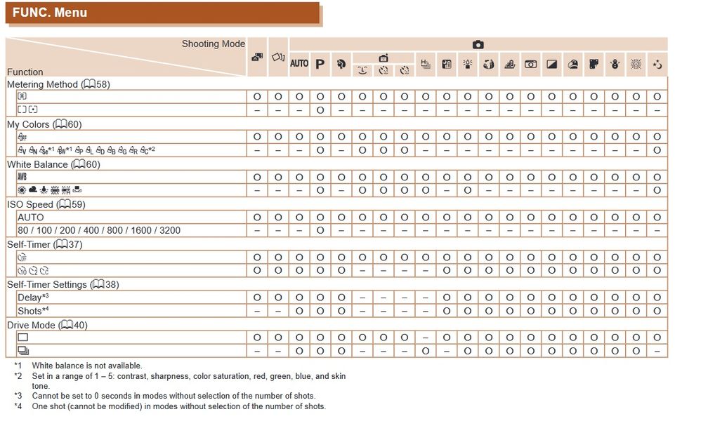

I just thrifted a Canon Powershot sx610 hs and when I wanted to switch to program instead of auto. However, when I press the “FUNC/SET” button, it only shows “self-timer” and “movie quality”. So can anyone help me? I wanna be able to find setting such as ISO or white balance.
Solved! Go to Solution.
01-10-2025 01:27 PM
You need to be in P mode
Here is a selection (1 page out of 3) of what you can set. Note that P mode allows you to set everything

01-10-2025 01:33 PM
THANK YOU SO MUCH !!!
