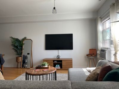

I attached two photos, one taken on the camera and one taken on my iPhone. If you look at the window on the right: the blurry one is the camera and the sharp one is my iPhone. I also exported this as the highest resolution from the camera into the canon app.

Hey, Storres - You present an interesting Mystery. 1. It is certainly NOT related to the size of SD card, or no. of images stored on it. Is the "blur", you perceive is on ALL images, or just indoors or low light? Reason I ask is that image above has a BLACK rectangle at center, and "blur" most obvious at the window - "highlight". I mentioned that our little cameras have great, large lenses ( for a little P&S) I dunno how much you know about Photography, or lenses, BUT - your Powershot and iPhone have very different lens size. With a larger (diameter) lens, a subject can be emphasized (eg portrait, or food ad) by opening lens, which reduces depth- of- field (DOF). The subject is in focus, background all blurry. - They call it "bokeh" these days ( Japanese for blur). This is used widely in portrait and ads. That is by setting wide aperture ( low f- stop). That is impossible with the tiny lens on phone, but maybe iPhone does it by electronics. SO - if your camera's focus is "spot meter" ( one point), or center- weighted, on that BLACK TARGET, it would open- up the lens, and "blur" everything else. I'm just guessing, here - are ALL your camera images blurred, or just low light, or ondoors ?? ** Check the "metering" function, it's on top of the list on my 510 HS. I always use " center- weighted", but must remember, if a subject is off- center. -Pressing the shutter button half way, and held, will lock focus and exposure, on most cameras. I can only advise you look at images on a larger monitor, to figure out if the whole thing is "blurred" or just the part outside DOF.
If you can talk with a photographer at a camera shop (that still exist), or maybe a PAWN SHOP , politely ask, and they might be able to advise.
**Check the "metering" setting on camera , first - it might be set at "spot meter"...
**Thanks for the interesting puzzle. It is also possible that your lens is damaged, internally ( did you buy it used, or have kids who might have dropped it ?)
Again, good luck and safe travel. -Mark T, 930 AM Saturday
