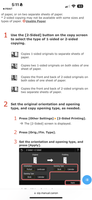

How do I set up 2-sided to 2-sided for copying on my imageCLASS MF751Cdw? There shows to be no ability available only 1>2 but the manual says that it can do that process 2>2? I am using LTR sized paper and have it selected as well in settings.
main Controller v6.03 ROM 2.04 DCON 4.01 language 1.15

However, I’m looking at copying 2>2 not scanning and the manual does show it’s possible.

I can't find anything definitive In the manual (751/753) to differentiate between the two models. At this point, I suggest you contact Canon support to get clarification. Please post a follow-up for the benefit of the community.
