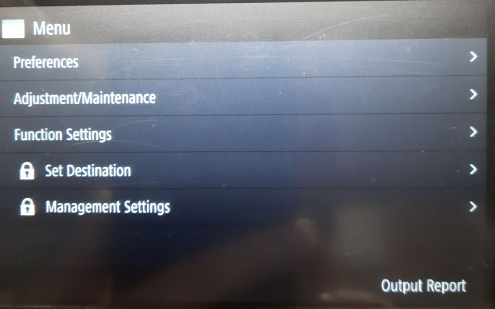

I took pictures of the "path" using my 743 (which is the same physical printer as the 731/733/735/741/745). Menu->Adjustment/Maintenance->Adjust Image Quality (and Maintenance).
From the "Adjustment" menu, try running the first three selections. From the "Maintenance" menu, try running the first three selections. See if any of that makes a difference.
When selecting "Adjust Gradation", the printer will create two test pages containing color patterns using all four colors. Does the first one look OK? or is it, also faded? 🤔

Under menu I find no place to adjust print settings. My color cartridges are down to 20% but no warnings.
Cannot find a "settings" under menu. Can you send path? Sorry to be so dense but the problem has never appeared before and product has not needed this kind of manipulations before.

10-08-2022 08:45 AM - edited 10-08-2022 08:52 AM
