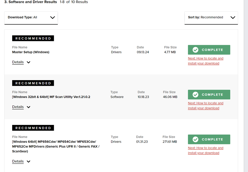

I've seen stuff about this online, with people having the same problems. Their solutions haven't worked for me so far. Just today I uninstalled all Canon apps from my computer and reinstalled them. Same error. Can anyone help? I installed the three recommended software packages/drivers. Let me know what other info you need. I'm decent at poking around till I figure out how to make things work, but I'm no tech expert.

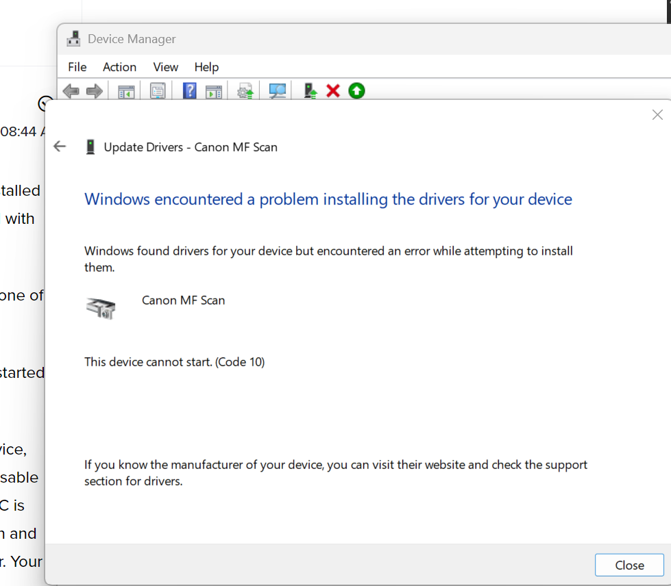

I also tried the "fix" in this thread. Was hopeful...but still no luck. I was able to run through the suggested process for the printer itself. But on my computer, the printer only showed up once in the devices dropdown, with MF Scan below it. Like I said I was able to do what he recommends for the printer, but when I try it for MF Scan, I get this:
Oh well. I was hopeful for a bit there...Still a possibility I'm just missing a step somewhere. I think I'm following the directions exactly, but who knows.

If you are installing under Windows, you only need 2 installer packages.
The 2nd and 3rd from ZO's image above.  MF Printer diver /Generic UFRII and ScanGear installer.
And
The MF Scan Utility v1.21.0.2
The master setup is not needed, (Its optional)

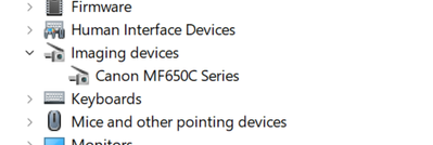

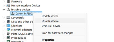

Updating the driver using the entry or entries under Imaging Devices is correct.  You'll have more than one listing if you have used more than one connection method (one could be wireless, one ethernet) are examples.  To windows these are separate interfaces.  I have only used wireless, so I only have one entry.
Note you have to right-click and disable the device before performing the update step.
In cases where multiple installs were attempted and failed, it may be wise to remove the printer, uninstall its software and restart the PC before installing again.  I have used the Device Manager update method with Windows 11 24H2 successfully.  Its not needed for Windows 10 or with an earlier feature release (like) 23H2 (Windows 11).
