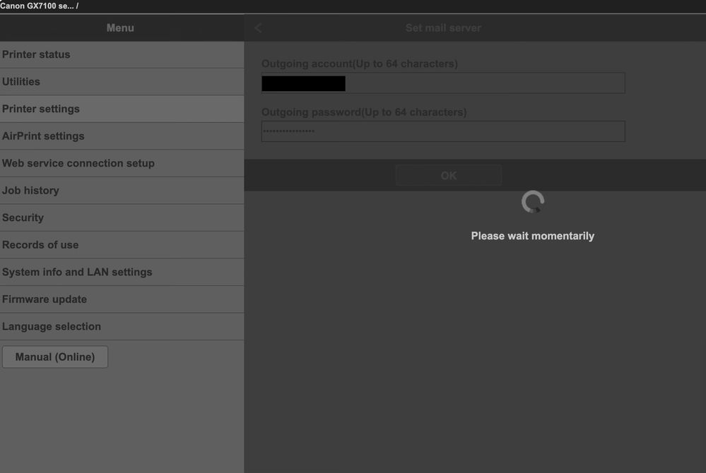

Successfully setup up and utilized scan-to-email via smtp2go.com on my GX7120 but out of the blue this feature no longer works.
When the printer tries to send the document, it fails with "Error 3423". Via the Canon's Remote UI (web-interface) the smtp-test only shows "Check Printer".
I thus decided to just re-do the entire SMTP setup, but it turns out that this is no longer possible either. Whenever I try to complete the setup, it reads "Please wait momentarily" and that's it. There is no action even after 10-15 minutes of waiting.
Even testing around with wrong SMTP information does not lead to a different outcome. No errors, just "please wait momentarily".

02-11-2026 10:02 AM - edited 02-11-2026 10:03 AM
@Shadowsports:
Nothing was changed when the problem occurred and there are no known issues with SMTP2Go. It just stopped working out of the blue.
In addition, I can no longer successfully configure the printer in the first place (see screenshot from my original post).
Regardless of what I enter, the final submission ends up in a waiting screen that never gets resolved. I don’t see how this is not the printers fault?
