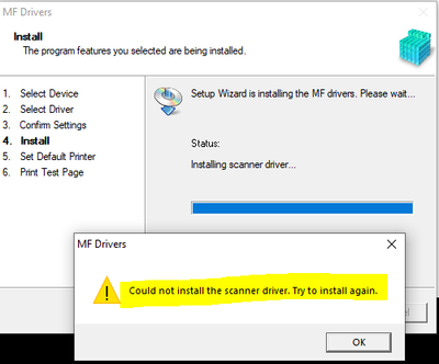

I have been having this problem for months (years?) and have GIVEN up, after spending hundreds of $$ on genuine canon printer ink, I cant use the scanner!!
1. "Could not install the scanner driver. Try to install again." x 10000
followed when I run the MF utility:
2. "A scanner driver supporting this software is not installed.  Install it and try again". - SEE #1  !@#$$
HELP!

the software I installed is:
File Name[Windows 32bit & 64bit] MF Scan Utility Ver.1.21.0.2
TypeSoftware
Date10.18.23
File Size46.06 MB
from https://www.usa.canon.com/support/p/color-imageclass-mf743cdw
The printer and fax installed fine, but the Scanner did not, and gave me the following error:
I tried installing just the scanner, multiple times, all failed.  Ive tried completely uninstalling everything, reinstalling, and still the same problem.
I can print just fine, but cannot install the scanner, let alone use the MF Scanner tool, which of course does not find the scanner when I open it, because the scanner isn't "installed".

I just wanted to reply to confirm that Webroot WAS the problem; that, and I found the installed scanner under Device Manager, was *disabled*.. so every time i'd try to install it, it would install another disabled version (or webroot was disabling it), to the tune of 8 or 9 scanners 😄   Uninstalling Webroot, deleting all but one of the scanners in DM, enabling the last one, did the trick.
THANK YOU!
