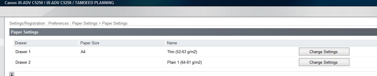

Iam a beginner in canon service. Any one can help me how to set the paper size in A3 drawer. Error message coming set paper guide shown in th illustrion to the correct size for the paper size. It was setted by A3 and automatically deleted. Pls find the screen shot A3 is empty.

Normally if all You have to do is open the A3 cassete and just slide the paper guide to suit your papers size and automatically Your machine will detect the paper size .
Please note that if there' paper stuck between the cassete and the cassete size detection switch which is located
in front of the cassete when You slide the paper cassete forward, The size detection may be displayed wrong ong the controll panel .
