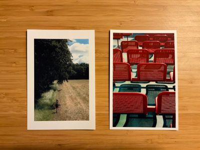

07-31-2026 09:49 PM
Hi there,
I am suffering from exactly the same problem. When I print from the app, I can successfully choose between borderless and bordered images and the bordered options prints correctly, with an approximately 4mm border on all edges. However, if I print directly from an SD card and choose the bordered option the print borders are much wider, closer to 10mm on all sides. There is no option to set the border width in the menu on the printer itself, so this difference between the two print methods is very annoying.
I have attached an image to illustrate the problem; the print on the left was made direct from an SD card, while the print on the right was made via the Canon Selphy app, both with the border set to “bordered”.
Hopefully, this is something that you might be able to fix with a firmware update, as it basically make direct printing, using the bordered options prints useless, due to the overly large border area.
Many thanks.
