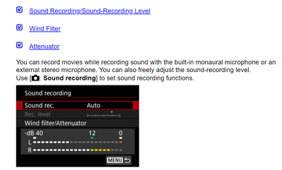

Hi Nate,
It depends on the camera. Some models have a headphone port which allows you to monitor sound. The mic only input models have a gain adjustment or attenuator control. Some also have wind filters. Here is an example of what you might see.
