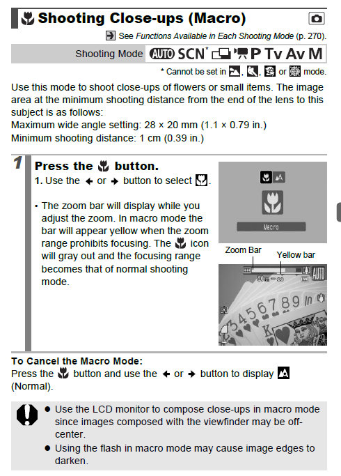

Macro mode is the close focusing mode and because it's so close you may need to use a tripod for really sharp results so experiment a bit. Because I don't have very fast internet service to speed up downloading manuals here's the instructions from my G9 manual which should point you in the right direction.
