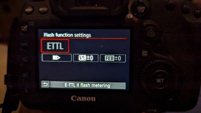

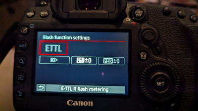

If you only need an on camera flash then wireless flash capabilities. Can be ignored unless you plan on buying more speedlites that have wireless capabilities. I have a mixture of old and new Canon speedlites and they all work fine. You can look on KEH.com, B&H Photo NYC Used Department or any other website that sells used gear. If looking for used gear stick with Canon because they can ensure compatibility. But a 3rd Party flash maker cannot. All Canon brand EX series speedlites such as 430EX III-RT580EX II420EX are all compatible. Just avoid very old speedlites ending in “EZ”. Those are designed for film cameras and are NOT COMPATIBLE with digital cameras. Also certain speedlites beginning with “EL” in the name are compatible such as the EL-1 EL-100. Other EL series speedlites are INCOMPATIBLE and are designed for use on newer EOS R series cameras equipped with a digital hot shoe. Just be aware that speedlites released prior to the 580EX II430EX II 220EX are NOT COMPATIBLE with the in camera flash menu. Which has been a feature in all cameras since 2007. When using older speedlites most settings must be set directly on the speedlite. The in camera flash menu will show items as grayed out or missing. Or tell you that the flash is incompatible. This is normal and should be ignored since the speedlite doesn’t support the newer technology that the camera has to offer. Below is an example picture of what the camera flash menu looks like when an older Canon speedlite is used. Most options are grayed or missing and the settings cannot be changed from the camera. The settings must be changed directly on the speedlite.
