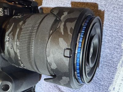

Check out Maven Filters. They magnetically attach to your lens via a screw on adapter ring or their clear glass Splash Adapter rings (which is what I use). Their filters are Tier One filters. They also make metal lens hoods which attach magnetically as well and will rotate with the Variable ND’s or CPL/LPL filters.
As a side note, I’ve fallen in love with their magnetic lens caps. No fumbling around trying to attach it when the lens hood is on or having to remove filters to use the OEM lens caps. All my Canon lens caps are now gathering dust in a drawer, lol.
My RF24-105mm L with a splash guard, LPL and lens cap; lens hood attached in reverse (and in case you’re wondering why my lens looks different, I’ve covered it with an AphaGvrd lens skin).
