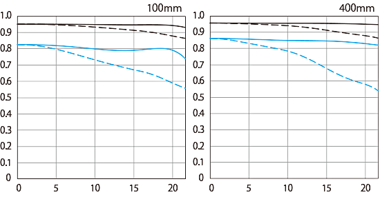

Usually, the best part of a lens is the center and not the edges. The APS-C camera only uses the center of the lens and so the photos will be of better quality than the same lens on a full frame camera.
For example, the MTF chart for "EF100-400mm f/4.5-5.6L IS II USM" shows better resolution and contrast 15mm from the center of the sensor than 22mm from the center of the sensor. The sensor on an APS-C camera is 22.8mm wide, so half would be less than 12mm. The full frame sensor is 35mm wide, so half would be 17mm. The distance to the corners is a little more.
