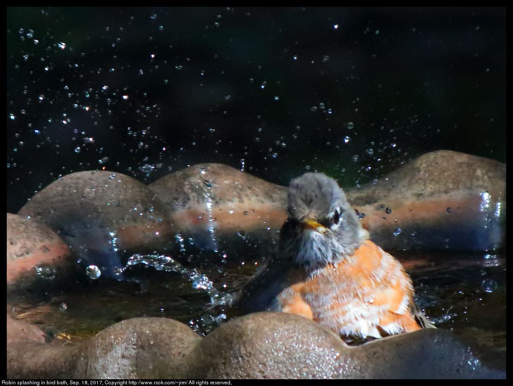

I have used the Canon EF-S 55-250mm f/4-5.6 IS with the Kenko Teleplus HD C-AF 2X DGX teleconverter to get 500mm focal length. I do not know whether the Kenko is still available.
https://www.rsok.com/~jrm/2017Sep28_birds_and_cats/2017sep18_robin_IMG_6515c.html
The reason that the focal length is listed as 500mm for a 250mm lens is that a Kenko Teleplus HD C-AF 2X DGX teleconverter was attached. This photo was made hand held through a window from inside the house. F/11 is wide open for this combination of lens and teleconverter. The F6.3 listed is incorrect and two stops should be added. Auto focus was used. The combination of lens and telephoto converter confused the metering with a resulting very high ISO.The reason that the focal length is listed as 500mm for a 250mm lens is that a Kenko Teleplus HD C-AF 2X DGX teleconverter was attached. This photo was made hand held through a window from inside the house. F/11 is wide open for this combination of lens and teleconverter. The F6.3 listed is incorrect and two stops should be added. Auto focus was used. The combination of lens and telephoto converter confused the metering with a resulting very high ISO.
On a modern mirrorless camera, the lens works better than it did on my older cameras. The aperture will be very small so some sort of diffraction correction will be needed. The free to download Canon DPP software does this in "digital lens optimizer" and rawtherapee free software does this in "capture sharpening".

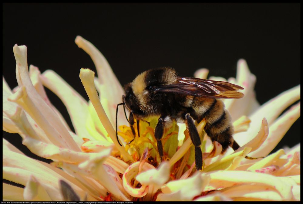

https://www.rsok.com/~jrm/2021Sep08_birds_and_cats/2021sep02_bumblebee_IMG_3837c.html
A Bumble Bee (Bombus pensylvanicus) was on a Zinnia in Norman, Oklahoma, United States on September 2, 2021. I made this photo with a very old lens as an experiment. I purchased the lens in 2011 and nearly wore it out. For this photo, it was attached to a newer camera body with an adapter with two telephoto extenders.A Bumble Bee (Bombus pensylvanicus) was on a Zinnia in Norman, Oklahoma, United States on September 2, 2021. I made this photo with a very old lens as an experiment. I purchased the lens in 2011 and nearly wore it out. For this photo, it was attached to a newer camera body with an adapter with two telephoto extenders.
F Number 16.0
ISO 5000
Shutter Speed Value 1/395
Focal Length 700.0 mm
Lens ID Canon EF-S 55-250mm f/4-5.6 IS
Lens ID Kenko TELEPLUS HD C-AF 2X DGX
Lens ID Vivitar SERIES 1 1.4X AF
