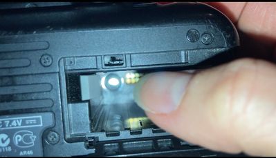

I’ve owned this Canon Rebel T3i since I bought it brand new, in 2012.
The past year the battery cover would randomly pop off, causing the camera to power off.
Now the camera is powering off without this occurring.
However, the cover was still having issues.
I’ve replaced the cover, but the issue still occurs.
Should I bother to send it in, since it’s so old, or buy a replacement body?
If a replacement body, what do you recommend that is compatible with the lenses, if not the exact same type?
Solved! Go to Solution.

As my colleagues have alluded to, it is unlikely that you will find it practical to attempt to repair this camera, given its age. There is no indication that the camera was unsuitable for your purposes, so one would expect that the same of slightly better camera at an acceptable price point would be a solution. As I see it you have a couple of options, given you current minimalist budget:
a) stick with the same budget and, as Rick suggested, get a better copy of the same body. This has the benefit that you can, if necessary, have spare parts for it as long as the model does what you want it to do. That is the least disruptive.
b) Save up for a longer period and look for an upgraded or newer model. Assuming you want to stick with a DSLR, you could look at Canon's Refurbished camera site - HERE or go to KEH and look at their wide collection of cameras.
