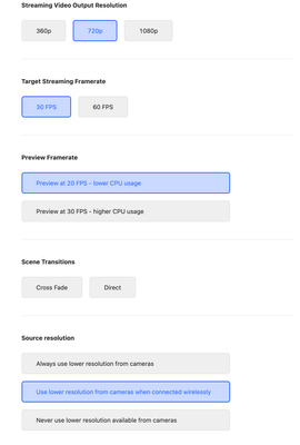

With an issue like this it would be good to check the video settings in the EOS Webcam Utility Pro software. It could be the software is using enough CPU processing that it is causing momentary freezes. To check that open the software, click on the gear icon to bring up the settings, and select the Video tab.
First try setting the Preview Framerate option to use the lower frame rate. Lowering that setting will reduce the number of frames it renders in the preview you see, but it will not change the number of frames your viewer sees. Doing that reduces the CPU processing without reducing the quality of the stream your viewer sees.
If the freezing continues then we would recommend going back into the EOS Webcam Utility Pro settings and try reducing the streaming resolution and frame rate to see if the same thing happens. Changing those settings will change the frame rate and resolution of the video your viewer sees.

Unfortunately, I'm already using all of those settings.
Again, its so strange because the older non-pro versions worked just fine. but having upgraded, it's decreased the quality of the product because it keeps briefly freezing my camera so often.
