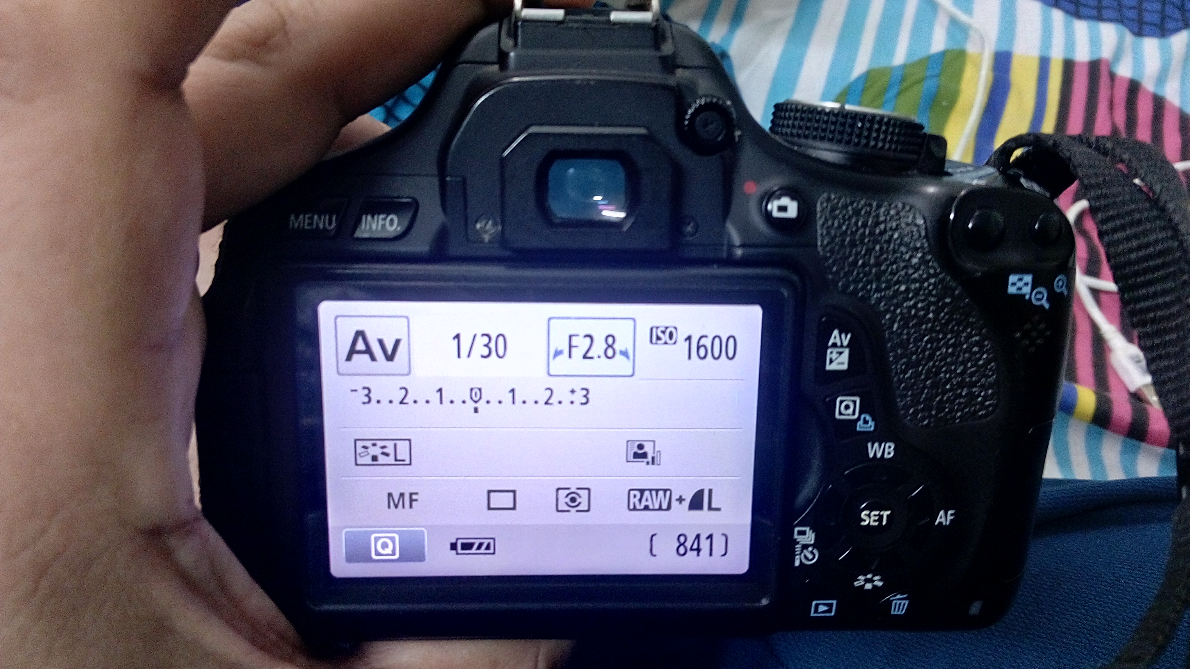

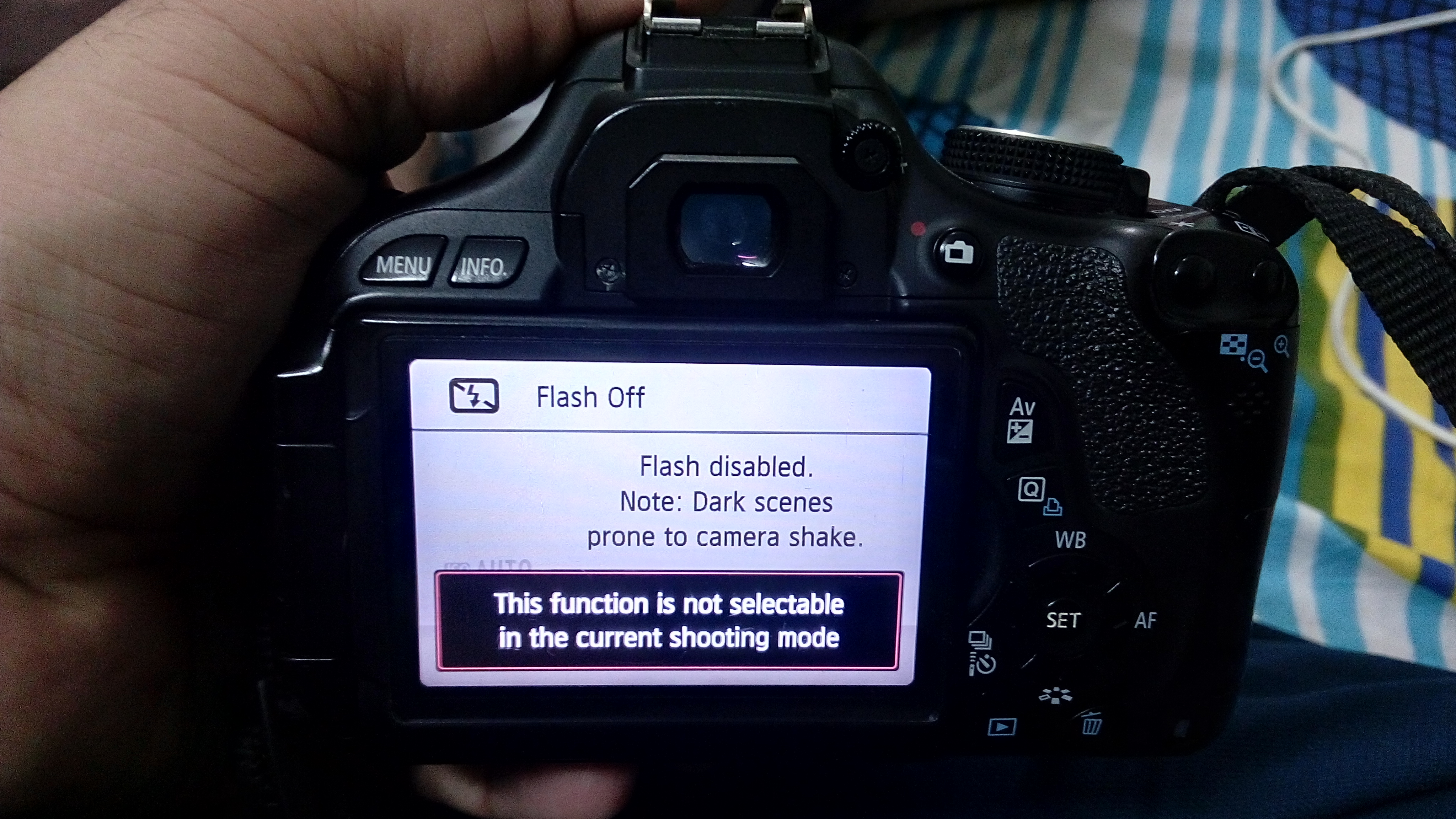

I am getting "this function is not selectable in the current shooting mode" in basic shooting modes. In advanced modes, I am not able to get any menu / info / live view display. Please help!
I can't remember the setting that fixed the issue (some button / setting combination) the last time.

Rotate the dial to Program mode (P).  In the basic modes such as full Automatic (green box) or the scene-based modes, many of the buttons on the camera that would change settings are disabled since the camera would select those settings automatically in those modes.
In "Program" mode, the camera selects initial settings as if it were in full automatic mode, except it will allow you to override just about anything you want.
Also, the menu options visible in the auto-matic modes will not show all settings for the camera -- it will display only menu settings that you are allowed to adjust in those automatic modes.  Switch to one of the creative zone modes (Program, Av, Tv, or Manual) will allow you to access all menu features.

Tim, thanks for the details. Currently, it does not display menu even if I click on menu button while I am in one of the creative modes. Is my dslr faulty?
While it is possible to turn the display 'off' so that settings are not normally displayed on the LCD and even images are not reviewed after capuring them, the LCD display should ALWAYS show the menu when you press the menu button on the camera (assuming the camera actually is switched on and isn't in the middle of another activity that makes it busy.
If your menu will not appear, it is likely that there is something requiring service (not merely an incorrect setting that you can reset yourself.)  There is no setting to disable the menu system.
It is also possible that the camera mode does not match the position on the mode dial.  Do you see the typical camera settings display on the LCD screen (does your LCD screen display the current mode in the upper left corner?  i.e. if you set the mode dial to, say, "Tv" mode, do you see the "Tv" letters displayed in the upper left corner of the LCD?)

Yes, I am able to see the TV or M mode options, like ISO, focal and so on. As per my understanding, I tried pressing all the buttons and seems to be working as such (will check again). One more thing I forgot to mention that I have Magic Lantern installed a couple of months ago. I think this problem is not related to it since this has happened before as well.
I am still checking on various combinations further.
