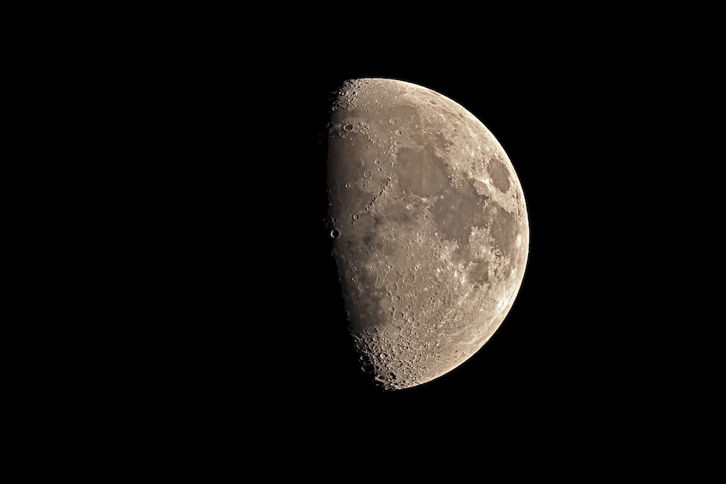

Here is a picture I took last evening with my 7D and tripod.
Canon EOS 7D, Canon 100-400mm 1:4.5-5.6 zoom lens, Extender 1.4 III, f/8, 1/250 sec, ISO-100, 560mm
Moon

Here's a moon photo... but this was taken with a Canon 60Da through an apochromatic refracting telescope:
Copernicus Crater

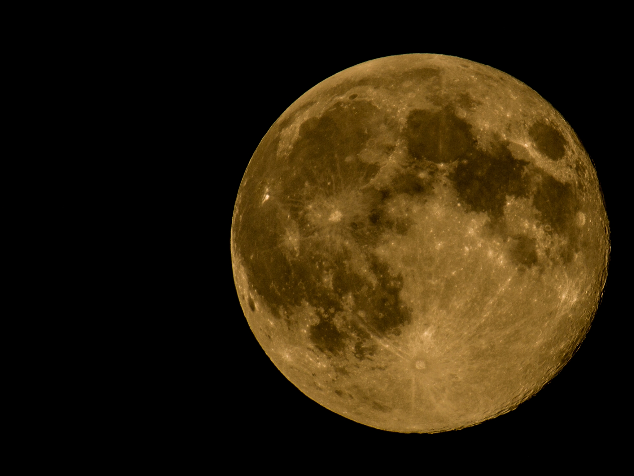

BTW, if you do want a full-moon photo of moonrise -- over some landmark (e.g. a city-scape, landscape, etc.) two tips:
1)  Find the date of the next full moon... but do the shot the evening BEFORE the full moon (not the night of the full moon.)  The moon rises nearly an hour later each day.  On the night of the full moon, the moon wont be rising until the sun is setting. By the time the moon is up, the background sky will be black.  The moon will appear "full" even though it's technically the night _before_ the full moon.
If you shoot the night before, the background sky will be dusky blue.  Usually the images look better -- the sky wont be completely black.
2)  Know where to stand.  To do that, you can get an app for your mobile phone (someone put me onto an app named "Sun Surveyor" -- that's the one I use) or use The Photographer's Ephemeris.  The apps are cheap (I think the 'desktop' version of The Photographer's Ephemeris is free... but you have to pay for the mobile versions.)  In any case... you drop a push-pin on the map showing where think you need to stand (you don't have to be accurate)... the app will show you the positions of sunrise/sunset moonrise/moonset relative to your position.  SO... if there's a landscape you want, drop a pin in the "approximate" position, it'll show you the actual position of moonrise... then move your pin until the line showing the direction of moonrise crosses above the position on the landmark where you want to to see the moon.  The app basically shows YOU were you need to setup your camera to get the moon at that position.
Personally i agree with fyigmo63... the moon looks more dramatic when it's near you can see the limb/terminator separating the day/night sides of the moon.  Since the sun is off to one side... you get nice long shadows which really helps show off the three-dimensional texture of the surface.  At the full-moon, the sun is basically directly behind you... providing a "flat" disc that appears 2D and not 3D.
