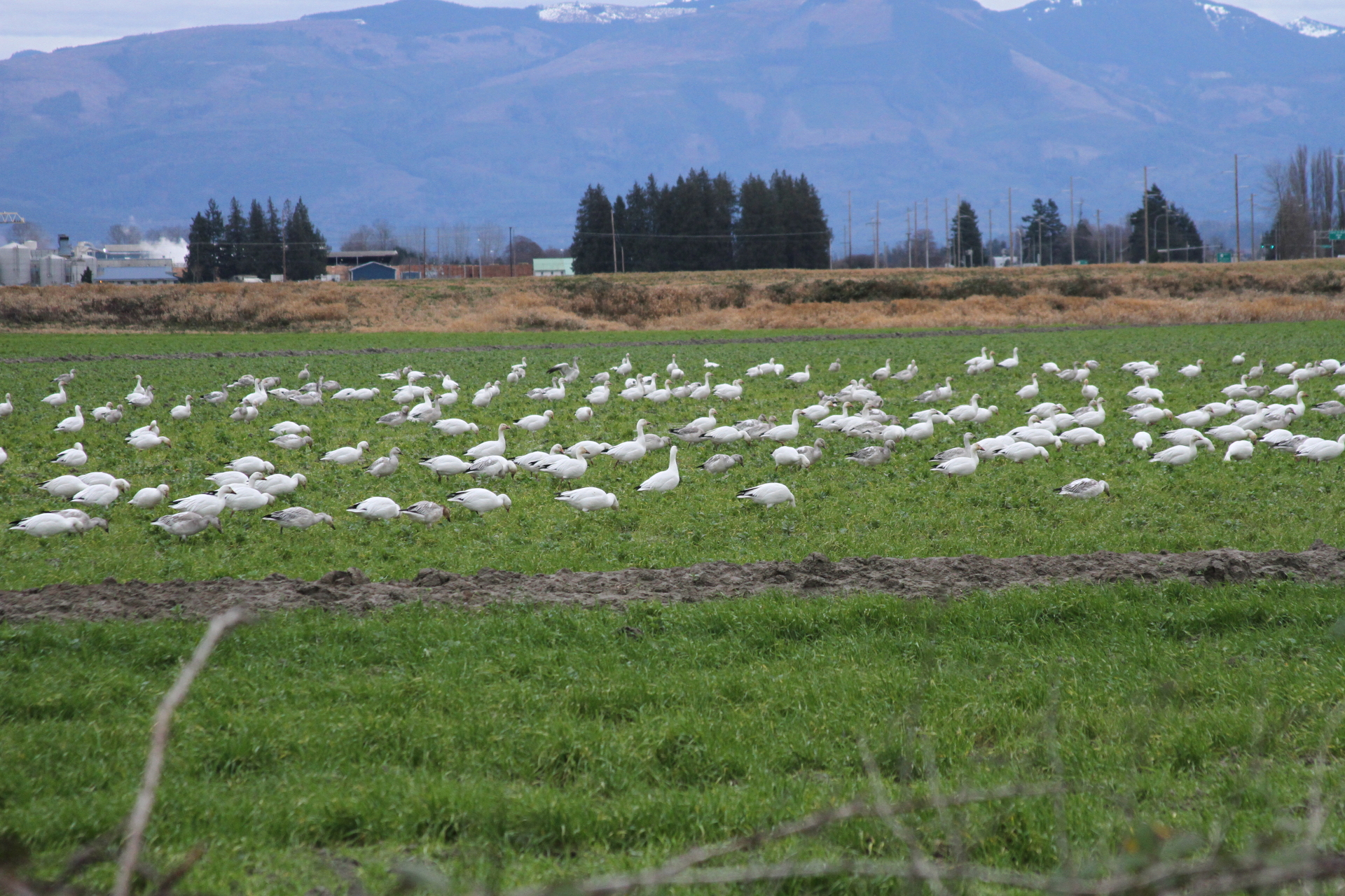

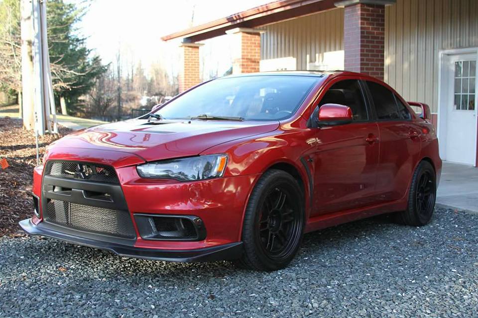

Secondy I would love to hear some tips on taking pictures of refective objects. I was invited to a small car meet Sunday and decided to play with the camera a bit again and again to me every photo is a tick out of focus. Below is my own vehicle, taken in the backwoods in full daylight, had the tulip on the ens and a decent UV Filter. Blow I feel I did better in the shade with the Evo, bit i know the camera can do better once I learn, how to shoot better.. Locomotive and anscape the same way. Is it me, my lenses or something amiss with the camera. Constructive Criticism Wecome. But be gentle..22792396_10210112024740903_2659765054890358801_o.jpg26239224_10210616446191124_5758172986413472960_n.jpg

#1 - Dump the UV filter.  That's making things worse, not better.  A "UV" filter was helpful in the days of film cameras where films were sensitive to UV light but it focuses at a different distance than visible spectrum light.  The result was that images could be slightly less sharp and the UV filter dumped the UV light and provided a tiny improvement to the image.
But with digital cameras, the sensor is natively sensitive to more than film and very image would look worse without filtering.  SO... the manufacturers all include UV and IR filter built into the camera (they are located immediately in front of the sensor).  Consequently an external UV filter is redundant.
But what could it hurt, right?  It turns out that smooth & flat glass surface on the filter creates reflections.  Light passes through, some light reflects off the curved front face of your lens, back onto the nice "flat" reflective surface of the filter, and back into the lens again.  This results in ghosting, extra flare, etc.
A lens can produce flare all on it's own ... but a UV filter will make things worse.
You'll want to avoid letting direct bright sunlight hit the front element of your lens (that's what the hood is for).  If the hood can't block the sun, you can use anything available (hold a sheet of cardboard just out of frame to block the direct sunlight from hitting the lens) to help.

Waddizzle, even though it was a bit nasty out I grabbed the camera and went out to look for Eagles and Snow Geese. First I tried the suggestions above then went back to my roots and put it in manual after seeing no matter what I tried in P Mode and even Av mode is the shutter wanted to be down in the 80-200 range and pics look okay but zoom in on the camera or on the computer and they are okay but not razor sharp like I want. So Manual mode see my F Stop up and set the shutter at 1/800. And set it so my exposure was one tick under center. And OMG presto that is the ticket. At full zoom 135mm on my IS USM Lens I can pick out the pupil clearly on the goose at 50+ yards. Got a few young eagles as well but I had nothing to frame it with as they were standing along a cut in a muddy old corn field. That is what I was missing was being able to adjust the shutter where I wanted, and like you said in some modes it's almost impossible on the fly to adjust the shutter. So I'm guessing at the lower speeds when I'm at mid to Max zoom even with the IS on its picking up my hand shake. Going to see if I can modify a side grip to work with the battery grip and I am using a Joby sling as it's far better on my neck than the standard strap. Just wish I could leave it on with the tripod shoe. I'll upload a few here in a while, see what everyone thinks. I also ditched the UV Filter, well I'm going to take it apart and have a piece of glass cut to fit to just be a lens protector and get a Polarizer on order for the USM lens. Already have one on my base lens that came off my old telephoto from my film camera. Need to get one for my Tamron 300 mm as well I stupidly left at home while testing. Lol.
Again many thanks, I may figure out how to save this setting I dialed in to one of the custom presets. I have yet to venture in playing with the settings for them.
I did crop this image to get rid of a bad backdrop of mud flats..  Shot in P Mode, shutter was 1/100, one click under center on exposure. (Eagles)

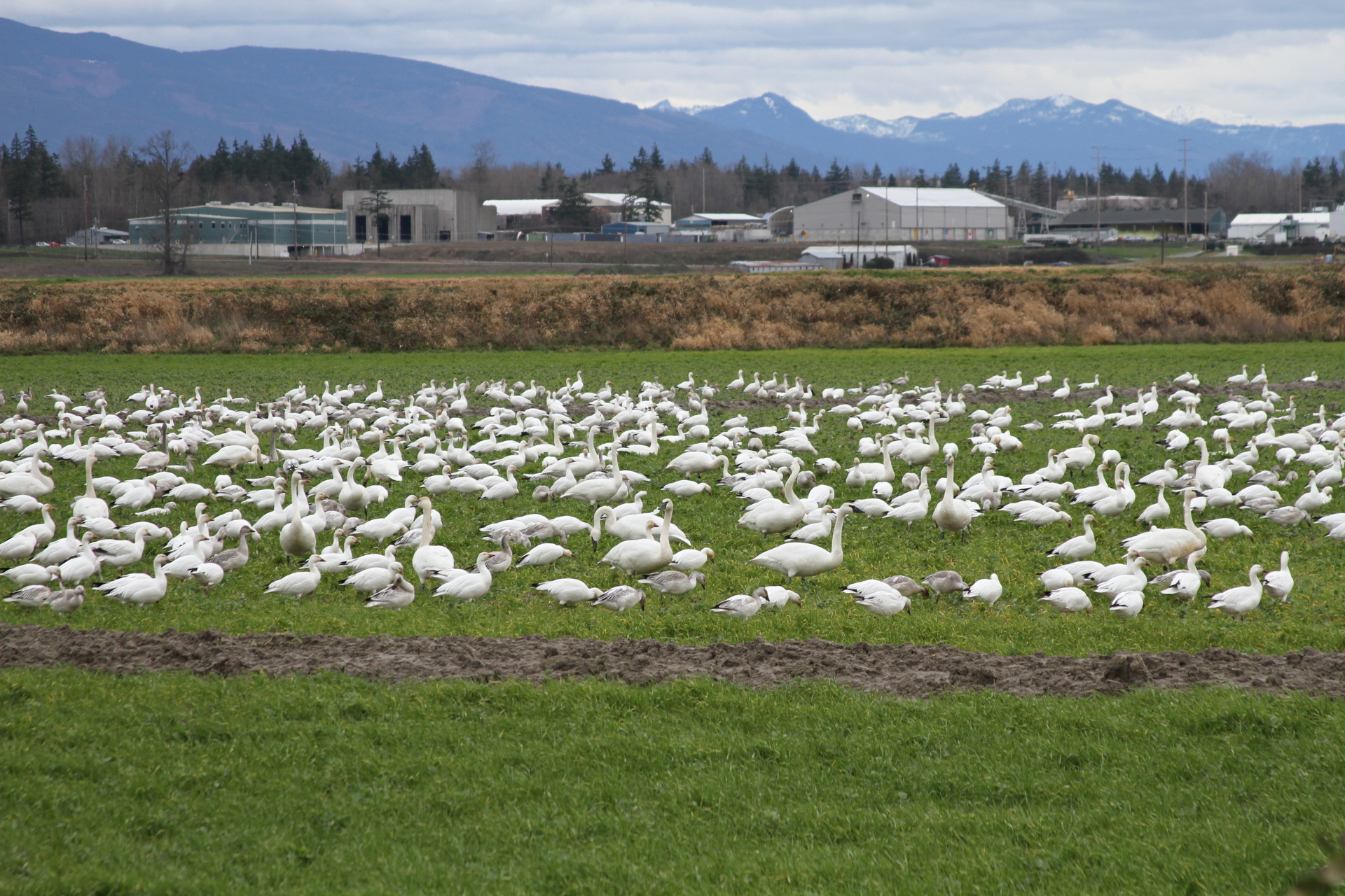

Shot in Manual 1/200 Shutter, Center Focus, One Shot (Large Group of Geese)

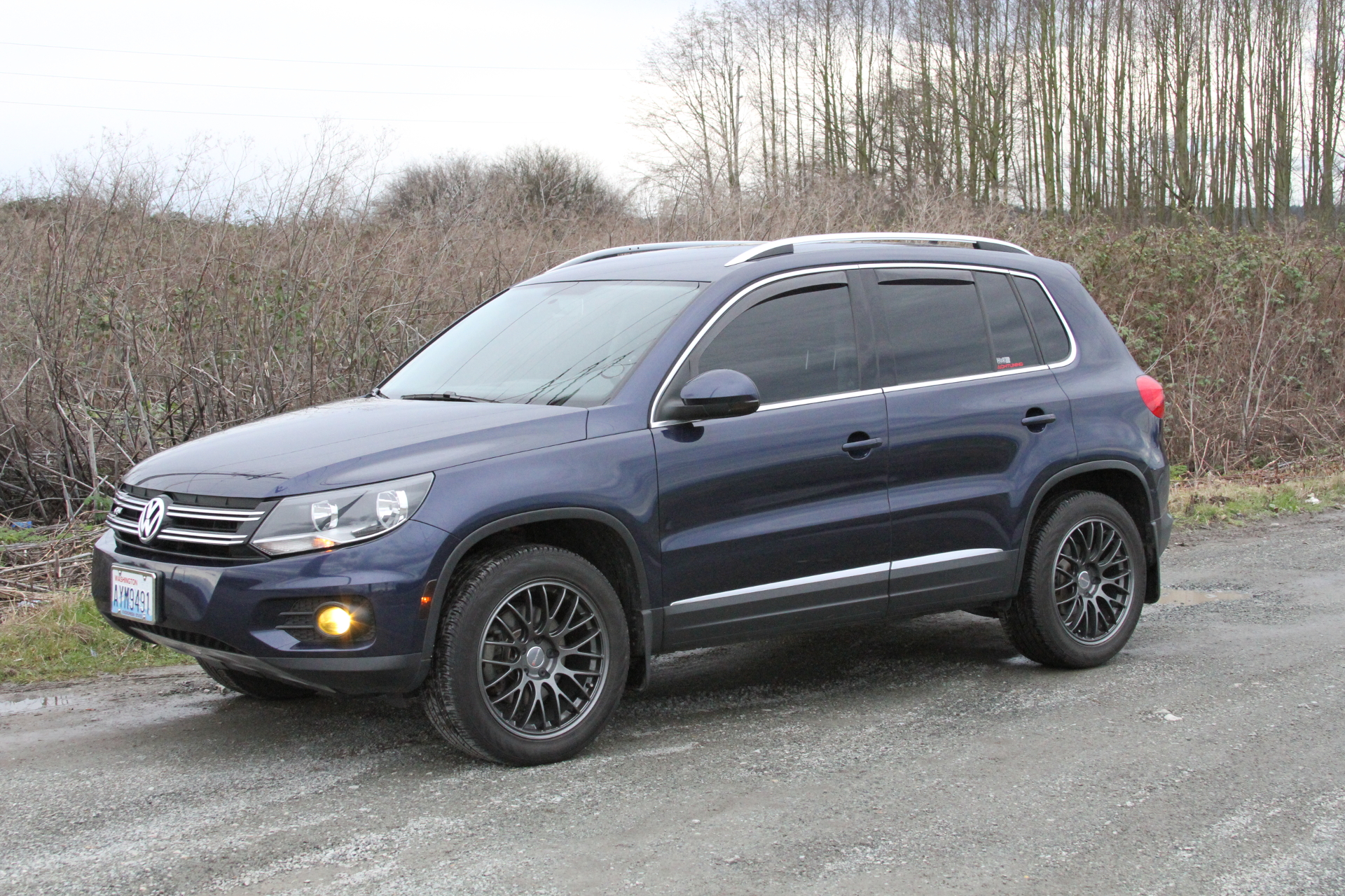

Shot In Full Manual, 1/800 Shutter, One Shot, Center Focus, No filter, One click under Center on Exposure, and Evaluative Metering. (VW Tiguan)
A bit better, but now I can start messing around with it, shutter speed was the key, along with learning to switch between the modes, on the fly.
