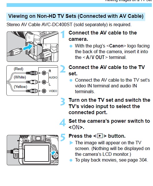

Does the original cannon cable have a bump on the botton to fit the buldge obove the I in digital below?

That is correct. The jack is non standard to allow for the Canon A/V cable:
and I have *never* had a standard USB cable come loose, though YMMV. I suggest you get a longer USB cable and create a strain relief pigtail, possibly taping it to the side of the camera.

I retrieved a highter quality USB cable from a Panasonic HVX200a kit that has an integrated ferrite choke and fits better. It does not lose connection. I saw a photo of an AV cable for composite video that has a bump to fit the Canon jack. The bump keeps it from being inserted into a USB port that does not support analog composite video and audio out.
The male portion of the mini USB cables Canon supplies do not have the bump. So the Jack on the camera is not standard, but is compatible with USB. I was thinking Canon was charging extra for a special USB cable.... but this is not the case.
