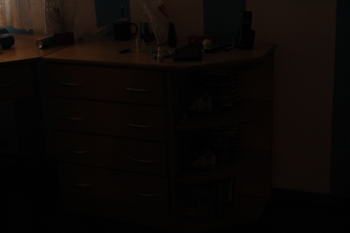

Hello! Im having a weird problem with my t5i. I tried everything, reset configs, change sd card, baterry and nothing.
My built-in flash is firing but on 90% of the time dont work (dont make any effect on the image).
Check this 2 images that I take with the Auto Mode with flash (on 2 images the flash normally works)
and the next one
I tried take a picture in a mirror with flash, but the flash dont appear on the image oO. Maybe its out of sync? I dont know what to do.
Anyone?
Thanks!!

Yes, I know commander mode and its not the problem. I tried everything and reset to factory defaults settings. Its not a problem with recycle because its random. I turn on the camera, take a shot and dont work, 5 minutes after, dont work again, and again, and sometimes work like 3 in a row.  BUT, the flash is "firing" at all times.

I can see the flash. Its working, BUT there's no effect in the image like the first image that I posted. I saw the flash but when I see the image its like have no flash at all.
Check out this 2 images. I saw the flash in both, but on the first image theres no effect.
Thanks everybody that is trying to help 😃

Can you upload pictures with Exif? Take a jpg and upload without photoshop or something else.
here:

And a similar one with exif and where the flash works?
