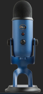

Is this the mic? Is has a built in amplifier. Does the noise decrease if the amplification is turned up or down?
