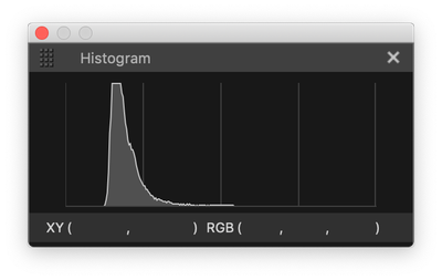

As for the histogram and that "1/3rd" point.  Generally you'll find the data is down in the lower 1/3rd or lower 1/4 of the histogram.
Here's an example:
(the above is from Canon DPP 4)
And here's the image it was taken from:
The above is a single un-processed frame (on of the frames from the finished photo).  I took roughly an hour's worth of data (the above image is an 8-minute exposure).  You can see it looks like it is upside-down (it is ... that's how it came out of the camera).   Notice the contrast isn't as good.  The disk structure is weak.  It doesn't even look like there is color in it (but there is).  Astrophotography images are usually heavily processed and the data is "stretched".  The color in the final image is based on separating the image into separate LRGB channels (L = Luminance channel) and then re-combining such that the luminance applies to saturation (the brighter it is, the more strongly it will be saturated).
