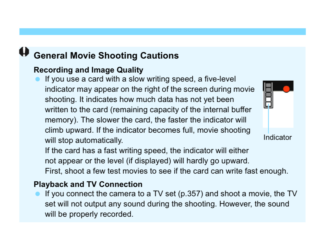

Your problems are most likely being caused by your memory card(s).
I suggest Sandisk Extreme 32GB.  Only use full size cards.  No micro-SD cards.  Format in the camera prior to first use.

That display only appears when the camera has to buffer data to the memory card.  If the card is fast enough, then the display never appears.  What video mode and frame rate are you using?  You may need the Sandisk Extreme Pro, or Lexar Professionoal for higher frame rates.

I am at 60 fps and I am using a SanDisk Ultra Plus. It's a 128 GB 80MB
There is little doubt that the problem is your memory card.
It is not rated for video.  This is probably due to the very low10 MB/sec write speed.  I recommend only SDHC cards.
BTW, even if that is not an exact match for the SDXC memory card that you are using, it does not change the fact that your memory cad is the problem.  There is absolutely little doubt of that.
I'm sorry, my friend did something with the settings and now it's fixed not sure what the hell he did but he fixed it. Thank you, all for the help.
