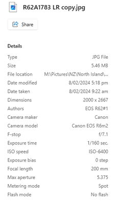

FWIW, I have the R6II, and just checked on the EXIF data, both using the properties of the file from Windows 11 File Manager, and Adobe Photoshop File Data:
cheers, TREVOR

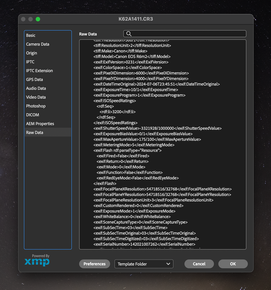

I took the Photoshop file info one step further because I had almost exactly the same info as your screenshot, so I went to the RAW Data option further down the list.  It has a lot more of the camera info, but nothing on IBIS.  I don't have Windows, I have a Mac, and I'm a bit surprised there is even less info.
Screenshot 2024-07-08 at 5.00.03 PM.pngScreenshot 2024-07-08 at 5.00.03 PM.pngScreenshot 2024-07-08 at 5.03.43 PM.pngScreenshot 2024-07-08 at 5.03.43 PM.png
