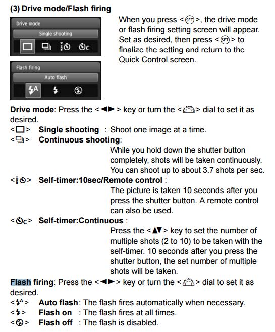

Let's analyze your sample pictures...you set Av to 1.8, Tv to 1/80 for both pictures but for the second one without flash..you upped the ISO to 400 from 100 (2 f/stops increase). This picture is still very under-exposed. For the flash picture (1st one, with ISO 100...it is even much underexposed by two more stops and even with flash it looks very dark. Problem is that we don't know whether the built-in flash simply didn't have even umph to light the picture up or it simply doesn't register. This is why the sample pictures you posted are not helping. You should have kept everything the same (don't change ISO) and fire off one with and without flash so we can see that the results don't change.
Let's assume the flash fired but didn't get registered...the only thing I can think of is that if somehow there is an option to prevent the flash from firing. If there is, you might be seeing the flash firing for focusing but not the actual flash. Check the menu and make sure the option is not set to flash disable:
