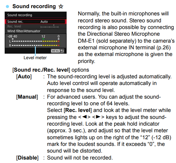

I wanted to offer a bit of clarity, as the manual can be confusing to understand. Where the manual indicates "manual," and "automatic," it's referring to the microphone's attenuation (volume control). Whenever you attach an external mic, it should be given priority. Here is a snippet from page 251 of the manual:

I believe his question is in regards to "M" Manual on the mode dial. From what i've gathered, you put the camers in "M" mode then choose your sound recording preference (Auto) or Manual). You can then change the Mode dial to your shooting mode preference.

The only shooting mode where a microphone is used, either internal or external, is in “movie” mode. The microphone is not used to shoot still photographs.
12-05-2017 11:03 AM
For the T6i, the "movie mode" is set with the power switch. The mode dial is still available for setting.
