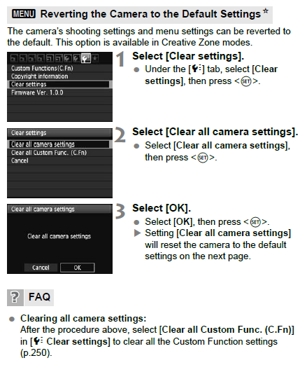

Bad news. There seems to be an issue with the internal focusing components on the camera - they could be out of alignment - or with the lens-camera communication. I am afraid you will have to send it to Canon.
The only other thing is to use the wrench menu to reset the camera.
03-23-2017 02:47 PM
Wrench Menu? I'm a novice here.

I'm saying this with caution but that seemed to have done the trick!! Thanks so much!
