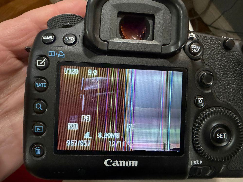

When I turn my camera on I'm seeing multiple verticle lines (different colors) on the display. I see the same lines when trying to view the images. I'm attaching a screenshot
Solved! Go to Solution.

01-28-2026 03:47 PM
Defective driver or more probably the LCD. You can plug a TV or monitor into the HDMI to see if it is the driver.

Hi,
I was able to grab a cable and plugged the camera into my TV. I can see the photos on it very clearly, no lines. I don't have the lens with me, and had tried to take a photo without a lens, it resulted in a white photo - would that confirm that the LCD is the issue vs the driver?
01-28-2026 09:43 PM
No you confirmed that your pictures are out of focus without a lens.
the fact that it is clear on the tv shows that you have a bad lcd.
