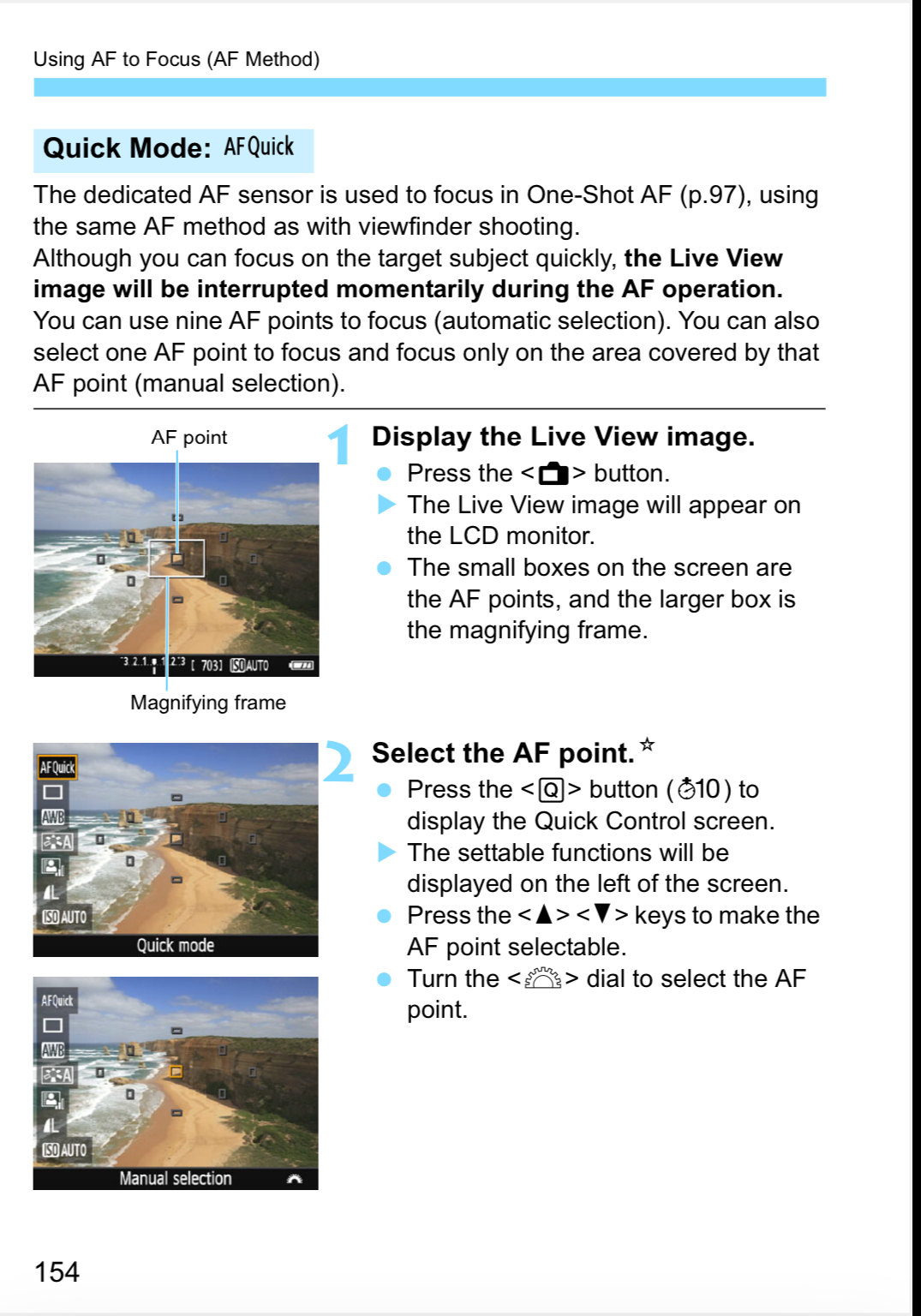

Changing AF points will not lock the mirror, I'm looking for Canon to add the feature in the next firmware update.
Canon is NOT going to add the feature.  Forget about that idea.  Why didn't you try my suggestion?  I didn't ask you to change the AF points.  I asked you to chang their behavior. Is "Quick Mode" available?
@MacroDave wrote:
@Waddizzle: I think I'm not understanding - how would changing the AF point modes lock up the mirror?
YOu could at least try it.  Let me know what happens.  Good Luck.
@rrrccc01 wrote:
Actually, that description sounds more like you need a better tripod head.
"I guess I didn't make myself clear."  I just told you how to do Mirror Lockup on your T7.  You have to use Quick Mode to do it manually using Quick Mode in Live View.  It will not do it automatically.  Similarly, you cannot adjust exposure in less than whole stops, but there is a manual work around to do so.  Use Exposure Compensation.
Canon will not update the firmware to do it automatically, either.  You will see.
My work is done here.  Good Luck.
AF is not in play, your "work" is done
