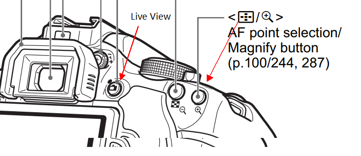

Gil,
It sounds like you're confusing Live View (the LCD view) vs using the viewfinder (eyepiece).
When you use Live View, it will allow you to confirm focus via the viewfinder, and use the magnify/Reduce button to zoom in/out digitally. This zooming will have no impact on your photo. You can then twist your focus ring to manually focus while you're zoomed in to ensure the area you want is as sharp as possible.
If you're looking through the viewfinder (eyepiece), which is the default mode for the camera, the Magnify button is your AF Point Selection button.
See Below:
If you're wanting to use this feature, you'll want to enable Live View by pressing the button with the Camera/Red Dot icon next to the viewfinder.

The camera will only do that if you put it in "live view" mode.   You activate that using the button immediately to the right of the viewfinder.
When you push this button, you'll hear the reflex mirror swing up and the shutter opens ... and the camera will start displaying the image on the LCD screen.  From here you can use the magnifier buttons to help refine focus.
