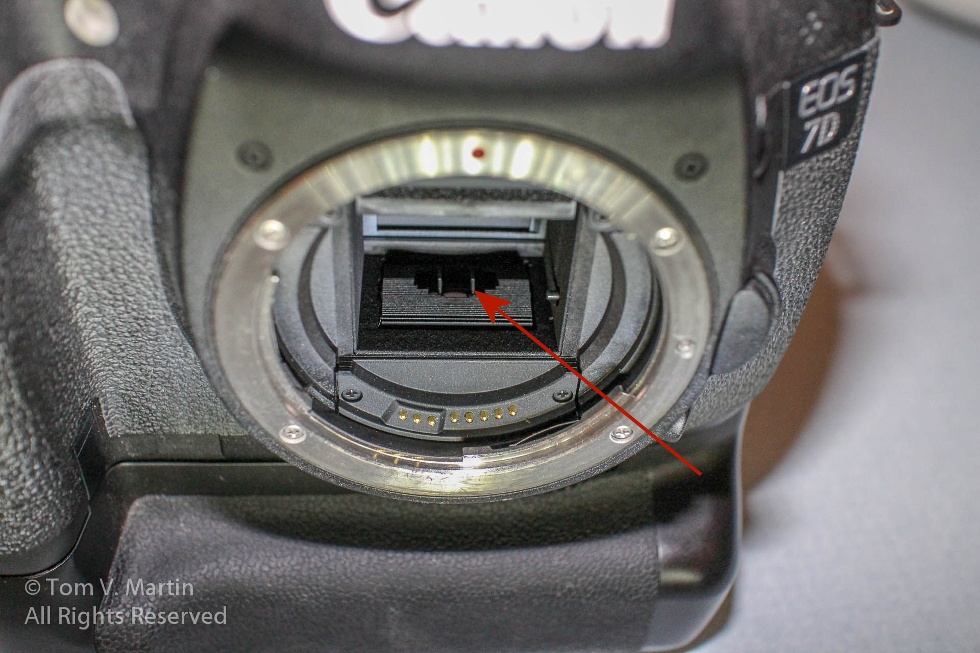

If so it could be dust on the AF sensor. The AF sensor below the holes shown in the photo. With the mirror locked up, use a bulb blower and blow the dust out of those holes. Do NOT use canned or compressed air to blow it out.

You can lock up the mirror by putting the camera in sensor cleaning mode. Please read your manual on how to do this. Also note when in sensor cleaning mode, both the mirror is locked up and the shutter is open exposing the image sensor. So after blowing off the focus sensor, you probably will also want to blow off any dust that may have gotten on the image sensor with the bulb blower also.
