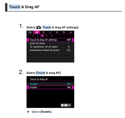

Wow, I have seen some strange answers to your question. There are various ways to tell the camera what you wish to focus upon, some a little too complex for your current level as a beginner. The simplest methods would be:
(1) touch and drag, where you look through the EVF while using the rear LCD as a track pad to move the AF point around the frame and drop it where you want it to focus,
See p.472 of the Advanced User Guide
(2) look up Customise Buttons and change the option for the Multi-Controller (Joystick) to have direct AF point selection. This means the multi-controller is always active and ready to move the AF point around the screen to where you want to focus.
See p.518 of the Advanced User Guide
You can then choose whatever type of autofocus point you want to use and move it around with the rear screen or with the multi-controller.
