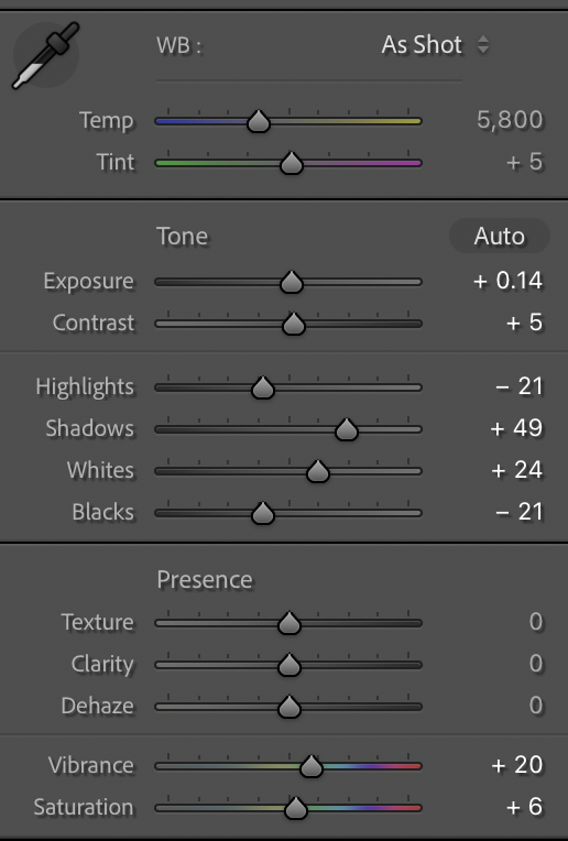

Hi there - I just upgraded to the Canon EOS R5 and so far my photos seem quite noisy. I was having the same issue with my EOS R which is why I upgraded, but now I'm thinking it's something I must be doing wrong in the editing process (or maybe my expectation are unrealistic)
This photo was shot on the RF 15-35mm 2.8 lens with the following setting
F16
1/320 sec
ISO 500

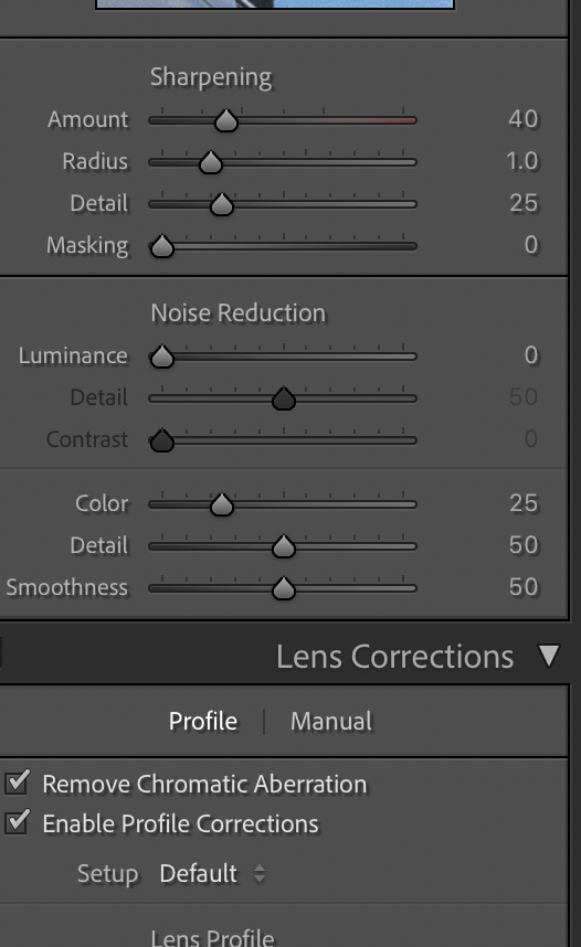

Here are my editing settings
Screen Shot 2021-06-22 at 1.05.46 PM.pngScreen Shot 2021-06-22 at 1.05.31 PM.png
It looks ok when you're zoomed out, but once you zoom in you see how noisy the photo is. I've added a screenshot of another photo too. Are my expectations are just too high? Or is there something I can do to reduce this without losing detail in the photo.
Thanks in advance for your help!

As an answer to your question about removing noise, DxO Deep Prime is making magic and is creating a DNG file without noise.

In the first image, you brought up the shadows by quite a bit (+49).  I don't think there's an excessive amount of noise for starting with ISO 500 and then boosting up the shadows that much.

Have you tried editing the raw file in DPP? Maybe start with default noise reduction chosen by the camera followed by turning off "Auto Lighting Optimizer" and turning off "Peripheral Illumination" and increase "Digital Lens Optimizer" by a lot to remove diffraction blur because of the F/16 and then go back to noise reduction and maybe it can be reduced to zero or leave it at the values chosen by the camera. At F/16 I would not expect there to be any need for correction of "peripheral illumination".

Depending upon the lens, "peripheral illumination" correction might add a lot of noise by brightening dark parts of the photo. Bringing up the shadows can also make noise more visible. Correcting for lens geometry can also make noise more visible. Unsharp mask can make noise more visible and increasing the radius while decreasing the amount might help. In DPP, increasing "Clarity" might work better than increasing the amount of unsharp mask. I do this while zoomed to 400%, but my eyes are old.
