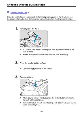

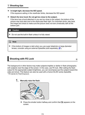

06-21-2026 12:01 AM - edited 06-21-2026 12:24 AM
It’s on manual Ive reset the camera flash and I have raised flash up and I’ve also checked the flash to be enabled and fire settings as well but when I take the picture it’s just a black screen camera battery is full I’ve already look up it on YouTube to see if that I can get help on there and I’ve tried everything
06-21-2026 07:55 AM - edited 06-21-2026 08:04 AM
“!It’s on manual Ive reset the camera flash and I have raised flash up and I’ve also checked the flash to be enabled and fire settings as well but when I take the picture it’s just a black screen camera battery is full I’ve already look up it on YouTube to see if that I can get help on there and I’ve tried everything ”
what shooting mode are you using? It doesn’t flash in all shooting modes. Try using Intelligent Auto, as shown in the image below. Use the viewfinder,
If it still doesn’t work, then you should try to reset the camera. You may need to change the top shooting mode dial to P to make reset option appear in the menus.
Retest using Intelligent Auto Mode. If it’s still not working, then your camera may need service.
