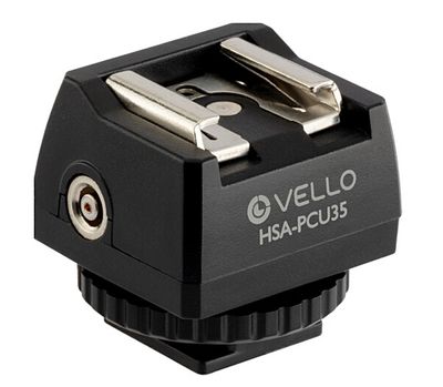

I have never heard of PC/P2 but PC sync connections are very common. You can buy an PC adapter for your hotshoe. Then just add a PC cable for the length you need.

The Vello adapter has both connections. They call 3.5mm (1/8”) mini phono port and a PC socket sync port. I have never heard of a 3.5mm plug being called P2.
03-16-2023 09:04 AM
If using 3.5mm (1/8) cables, be sure to check if the equipment would require mono or stereo. Some equipment could get damaged if using the wrong type.
