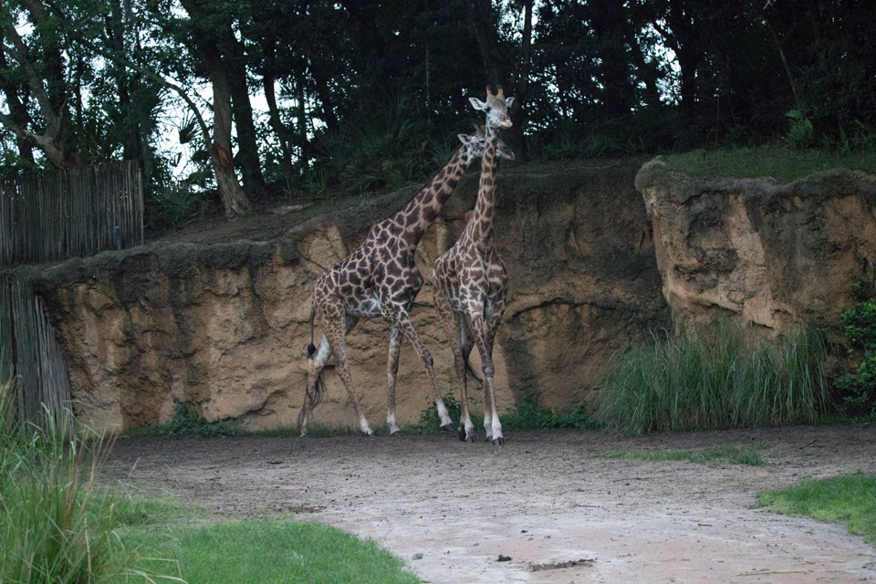

Here are 2 images shot seconds apart using auto ISO.    As you can see, one was shot at iso 20000 and the other at 8000.   Both were shot at 1/400 sec and f5.6
My guess is that Canon is correct it has to do with the lens's programing. Tamron reverse engineers how the EOS lenses are supposed to operate. They also have the lens 'lie' to the camera about its aperture so that an f/6.3 lens like the 150-600 can work with a camera that can only auto focus with a lens with a maximum aperture of f/5.6. Looks like somewhere there is a flaw in the Tamron's programming.
