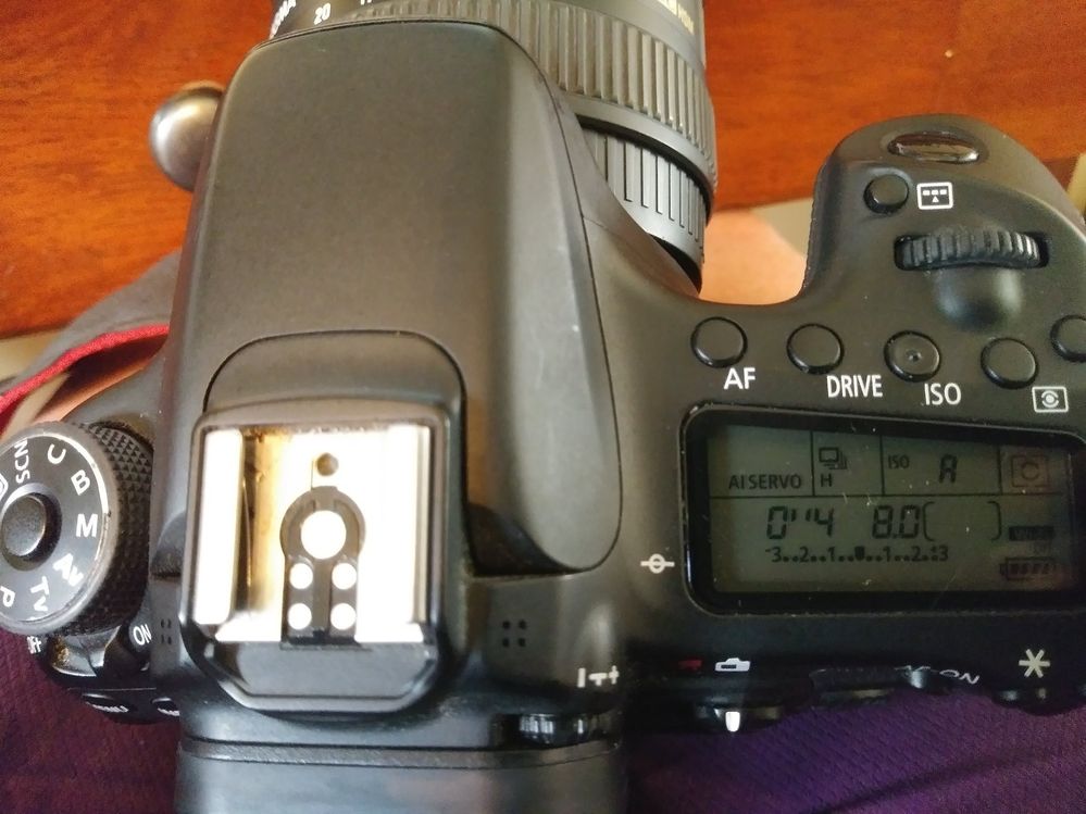

I handed my 70d over to my sister to take a shot and when she took it from me an error message flashed and it pretty much quit working. I'm hoping she just pressed some menu item or button by mistake! The msg flashed so quick there was no time to make note what it said. I was given back a camera with a black screen on the back; so now I can't navigate through any menus to find out what happened. There is also no shutter actuation when shutter button is pressed. I've changed out lenses. I've charged battery. Nothing. However, on the top nav window I can see I have a full battery, and can nav thru all the settings available, in both video and camera mode. So, I at least know the camera is alive to some extent. I've searched but cant find any subject covering this. Any ideas?? Here's a few photos of said camera. Also, dont know if my mirror is locked...could that make my camera behave like this? Thanks for any help. I miss my baby.28235418_10212713338281785_1346329982139683750_o.jpg

Yes- tried that. No matter which button I push, nothing illuminates on the backscreen. Nor on the internal viewfinder menu. Only the top external LCD do I find any similance of life. And that doesnt access menu.

I removed and cleaned around the eye cup (didnt see the sensor)... but even if that sensor was defective, that shouldnt stop the shutter from firing. It doesnt disengage the shutter when your face is pressed against the camera, under normal circumstances.
